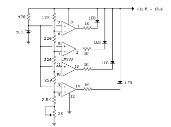

IL CIRCUITO COMPARATORE TENSIONE
Come si nota, il circuito si basa su un LM 339 che segnala accendendo diodi led :
IL PIN 1 METTE A MASSA IL LED AD UNA TENSIONE DI 11,8 VOLTS(25% DELLA CARICA)
IL PIN 2 METTE A MASSA AD UNA TENSIONE DI 12,1 VOLTS(50% DELLA CARICA)
IL PIN 13 METTE A MASSA AD UNA TENSIONE DI 12,4 VOLTS (75% DELLA CARICA)
IL PIN 14 METTE A MASSA AD UNA TENSIONE DI 12,7 VOLTS(100% DELLA CARICA)
PER LA TARATURA OCCORRE UN ALIMENTATORE VARIABILE MUNITO DI UN BUON VOLTMETRO E TARARE IL TRIMMER DA CIRCA 2 K.

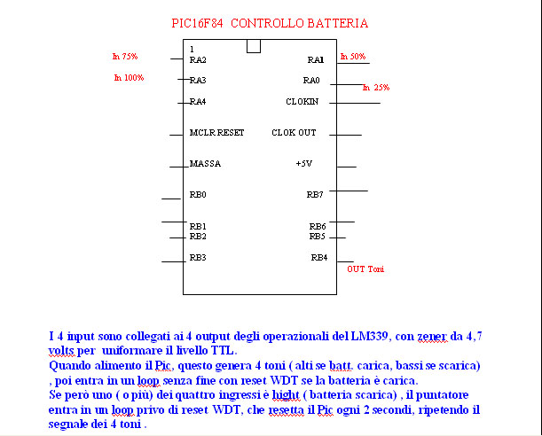

INTERFACCIA TRA COMPARATORE E PIC
LE QUATTRO USCITE DELL'LM339 (PIN 1-2-13-14) VANNO COLLEGATE RISPETTIVAMENTE CON RA0 DEL PIC16F84(PIN 17),RA1(PIN 18), RA2(PIN1), RA3(PIN2) CON IN SERIE RESISTENZE DA 4,7K E ZENER 4,7 VOLTS 1/4 W FRA GLI INGRESSI DEL PIC16F84 E LA MASSA- QUESTO NATURALMENTE SERVE A PORTARE A LIVELLO TTL TALI INGRESSI IN MODO DA RENDERLI COMPATIBILI CON IL PIC16F84.
iL PIC 16F84 VA ALIMENTATO NEL MODO CONSUETO, CON UN QUARZO DA 4 MhZ FRA CLOKIN E OUT E CON CONDENSATORI 22pf VERSO MASSA.
L'USCITA RB4 DEL PIC16F84 VA A PILOTARE UN TRANSISTOR DA CIRCA 1 A DI COLLETTORE ATTRAVERSO UNA RESISTENZA DA 2,2K COLLEGATA ALLA BASE DEL TRANSISTOR E RB4 .COME CARICO DI COLLETTORE DEL TRANSISTOR C'E' UN PICCOLO ALTOPARLANTE ALIMENTATO A 5 VOLTS(7805 CHE ALIMENTA ANCHE IL PIC16F84)
